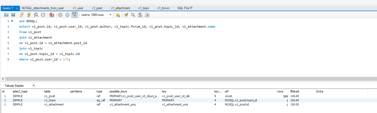

#60321
В тектовом виде такое. Оно? или что должно быть? ... |

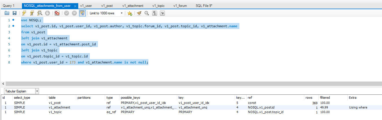

Горбатый ёж [игнорируется] Вот ещё вывод explain analyze Как только в читабельном виде отобразить... join Цитата [игнорируется] '-> Nested loop inner join (cost=473.95 rows=424) (actual time=0.235..3.066 rows=197 loops=1)\n -> Nested loop inner join (cost=325.38 rows=369) (actual time=0.154..1.790 rows=369 loops=1)\n -> Index lookup on v1_post using v1_post_user_id_idx (user_id=173) (cost=196.23 rows=369) (actual time=0.144..1.183 rows=369 loops=1)\n -> Single-row index lookup on v1_topic using PRIMARY (id=v1_post.topic_id) (cost=0.25 rows=1) (actual time=0.001..0.001 rows=1 loops=369)\n -> Index lookup on v1_attachment using v1_attachment_unq (post_id=v1_post.id) (cost=0.29 rows=1) (actual time=0.003..0.003 rows=1 loops=369)\n' Цитата [игнорируется] '-> Nested loop left join (cost=419.06 rows=212) (actual time=0.137..2.520 rows=197 loops=1)\n -> Nested loop inner join (cost=344.79 rows=212) (actual time=0.130..1.888 rows=197 loops=1)\n -> Index lookup on v1_post using v1_post_user_id_idx (user_id=173) (cost=196.21 rows=369) (actual time=0.093..0.869 rows=369 loops=1)\n -> Filter: (v1_attachment.`name` is not null) (cost=0.29 rows=1) (actual time=0.002..0.003 rows=1 loops=369)\n -> Index lookup on v1_attachment using v1_attachment_unq (post_id=v1_post.id) (cost=0.29 rows=1) (actual time=0.002..0.002 rows=1 loops=369)\n -> Single-row index lookup on v1_topic using PRIMARY (id=v1_post.topic_id) (cost=0.25 rows=1) (actual time=0.003..0.003 rows=1 loops=197)\n' ... |
